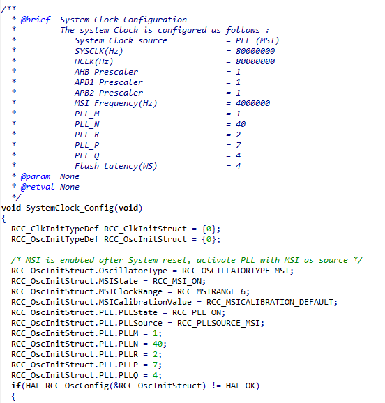

Hello @FPHIL.1 and welcome to ST Community,
After configuring the Clock tree in stm32Cube and generating the code, you shall find something like this
the RCC_PeriphCLKInitTypeDef PeriphClkInit = {0} functions is used to configure all peripherals clocks settings, such as frequency and prescaler. It is important to understand that all peripherals need to be properly configured to receive the correct clock frequency.
Hope that helps!

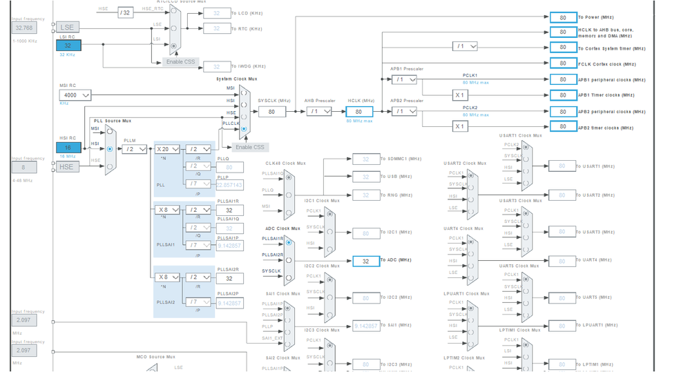

2023-01-30 11:07 AM
Your image is what I get. But I was expecting this as well:

What reference should I use on what to add to the generated code (like this) for other clock configuration details?.
