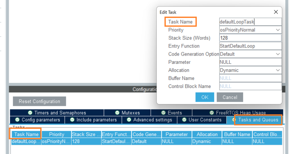

Cube MX seems to constantly confuse FreeRTOS Tasks and Threads.
Term Tasks is being used where Threads are being actually configured.
In FreeRTOS Tasks and Threads are two different beings.
This is super confusing.

and in top pic "edit task" everything is correct. except you believe only in Intel marketing , but then you should use Intel products only.

It is all about consistency, not tradition, marketing or history, and lack of consistency results in confusion.
FreeRTOS and ARM CMSIS RTOS2 wrapper for FreeRTOS delivered with Cube MX does differentiate Threads and Tasks. Generated code correctly includes Thread in variable names while GUI configurator mentions Tasks. It is a simple fact.
That is a fact, which proves that the same thing having two names creates a confusion!
> as FreeRTOS doesn't have the concept of processes (in the Linux sense), to avoid confusion
I cannot see how small RTOS not having processes at all creates any confusion. On the other hand calling threads, which small RTOS actually has, a tasks indeed creates a confusion. This topic is a good example of it - even after all the explanation, the topic author still thinks that threads and tasks in CubeMX are two different things...
