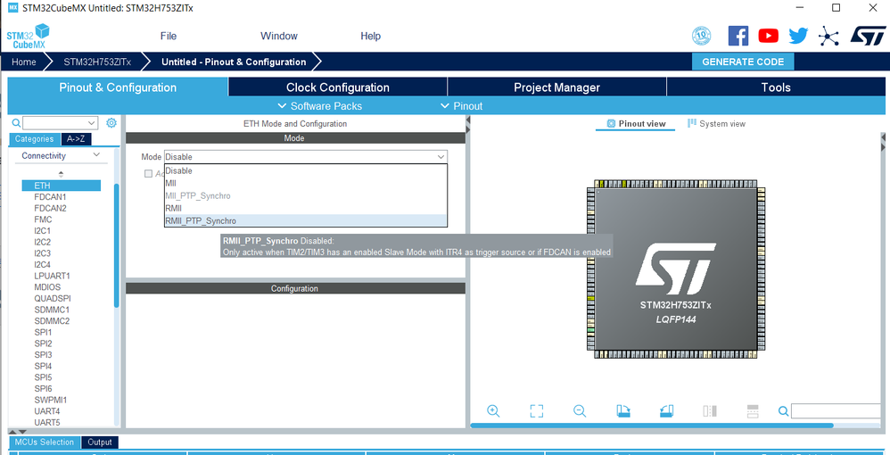

Hello @AFaya.1
RMII_PTP_Synchro is only active when TIM2/TIM3 has an enabled Slave Mode with ITR4 as trigger source or if FDCAN is enabled.
Best regards,
Nesrine
2020-10-08 1:36 PM
Hello @AFaya.1
Best regards,
Nesrine
