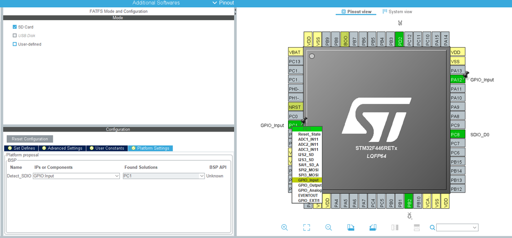

Hi @SSoni
It's Fatfs, and the tab / tab "Platform settings" that introduced this warning since 5.0.
For the mechanism of SD detection, it is expected to generate code (SD_Detected_PIN, a trick in the style) that takes into account "real" settings on the platform (the board)
By default, if we generate anyway, the function will be generated empty (look in the code generated by Mx).
So the user can believe that it is ok (it will compile, even linker), but the execution it will not do much on the call to this function of detection of an SD.
It is more a warning than an error Mx rating (it does not prevent the generation of code), even if in fact, for the execution it's not terrible if it's empty.
So to solve this problem you have to follow the next steps :
1- On the Pinout View, choose the pin relative to your SDIO then choose GPIO input
2- In the Plateform Setting choose the Pin that you have enabled on Pinout View.
3- Generate the code and all will happen to perfection.
You find in file attach a descriptive image
Best Regards,
Wael

2019-12-24 3:21 AM
I am facing same problem.
but didn't get the answer clearly. I have configured for 4 bit wide SDIO.
I see below are the pin details:
SDIO_CMD, SDIO_CK, SDIO_D1,D2,D3,D4.
What i understand from above solution is, Select any one pin (Other than above mentioned) which supports SDIO related and make as GPIO input. Is it correct?
