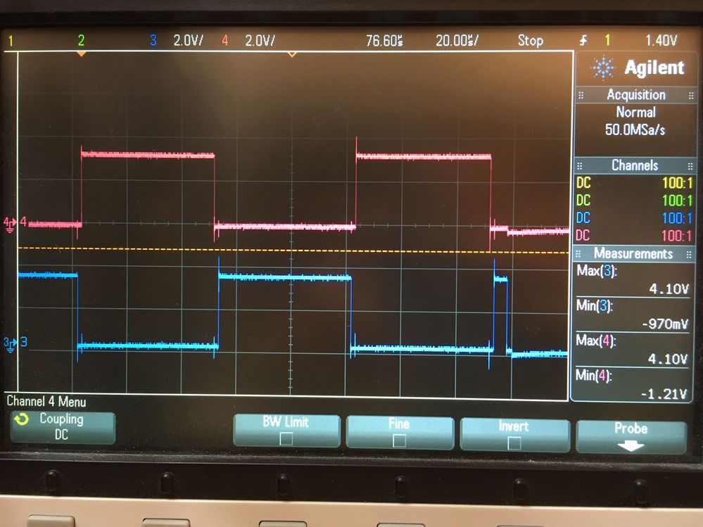

I work on 10KHz dual PWM (CH, CHN) generation with dead time implemented.
In error handle I want to stop the timer, and now I do it like this:
if(HAL_TIM_PWM_Stop(&htim8, TIM_CHANNEL_2) != HAL_OK)
//Error_Handler();
//Stop channel xN
if(HAL_TIMEx_PWMN_Stop(&htim8, TIM_CHANNEL_2) != HAL_OK)
//Error_Handler();
(duty cycle 50%)

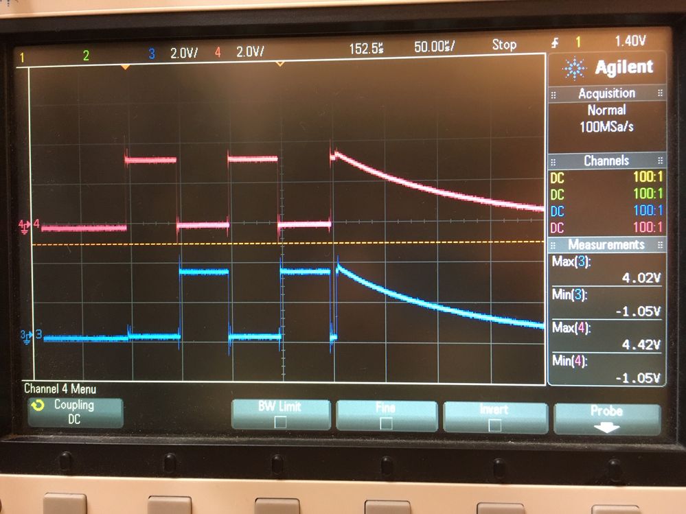

The first osci picture looks like its a good stop, but the second osci picture is totally bad.

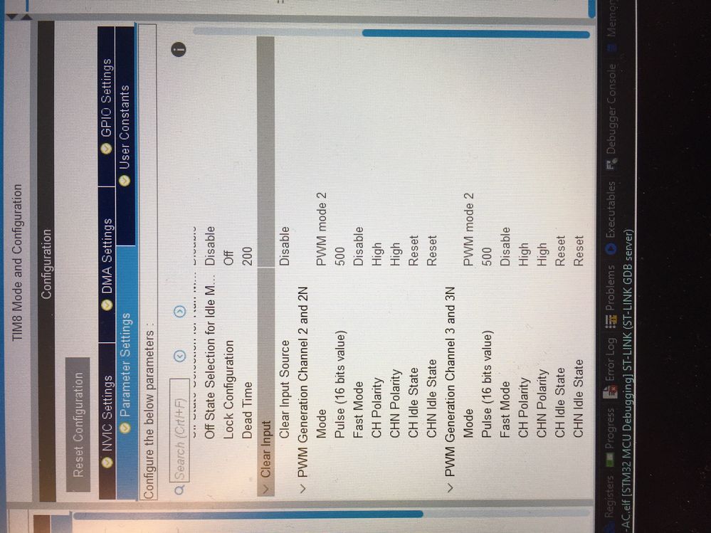

The thing, if I use the firt cube picture config, and change the time when I execute the STOP function, it create a peak on Negative channel.
The main problem is when the N channel output is high, when it doesn't need to be.
I does'nt really understand, why it switch pin to HIGH at the moment of STOP.
So my question is, how to stop properly the timer?

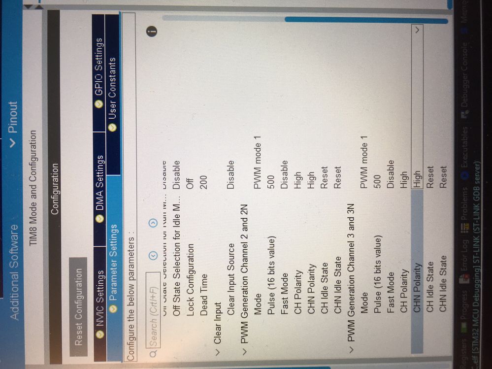

Do I miss some other configuration in CubeMX?
I have tried to change PWM mode 1, 2 and changing the idle state but it doesn't help.

Probably because in HAL_TIM_PWM_Stop() the first thing is that the CHx channel is disabled in TIMx_CCER, which has the side effect, that CHxN channel changes polarity. See the Output control bits for complementary OCx and OCxN channels with break feature table in RM.
Maybe reversing the two calls will produce the output you want. Note, that there are three states - driven high, driven low, and Hi_Z.

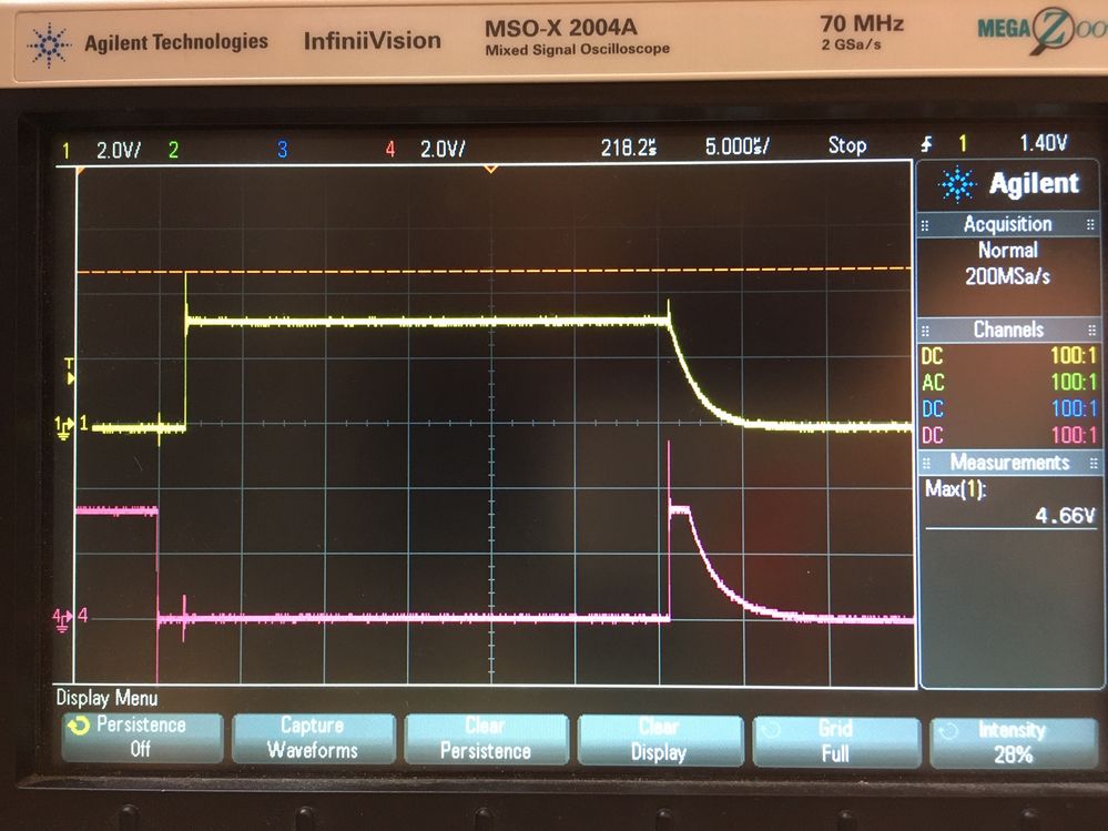

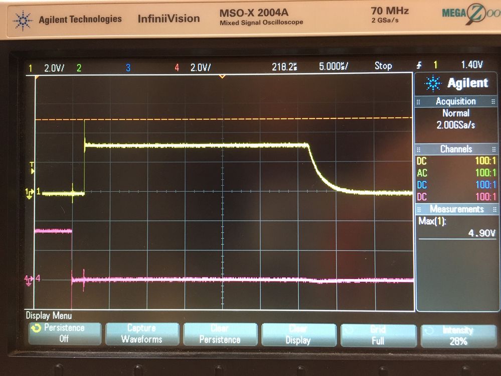

Here are two pictures, which clearly shows, what is the differences:
HAL_TIM_PWM_Stop(&htim8, TIM_CHANNEL_2) ;
HAL_TIMEx_PWMN_Stop(&htim8, TIM_CHANNEL_2);-------------------------------------------------------
HAL_TIM_PWM_Stop(&htim8, TIM_CHANNEL_2) ;Solution:
If you want to stop the timer which uses Positive and Negative channel, first stop the Negative channel, and after the Positive.
