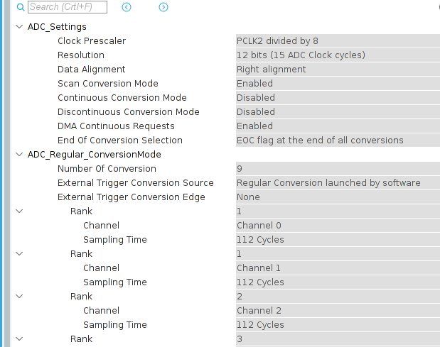

I use CubeMx 5.0.1, my project based on STM32F413 cpu and was migrated from previous version of Cube. I need to set ADC1 to perform multiple regular conversions. This is what Cube shows me:
You can see two entries marked Rank1. How can it be?
And if I generate the code, this is a fragment of code what I get:

{You can see that Rank 1 is configured twice. So, I suppose that only channel 0 will be converted.
Previous Cube version functioned the same way, so I suspected a bug and updated my Cube, but new version yields the same result.
Is it a bug in Cube or I'm doing something wrong?

2019-01-26 2:48 AM
Solved. I had to deactivate ADC completely in Cube, then start assigning channels from scratch.
