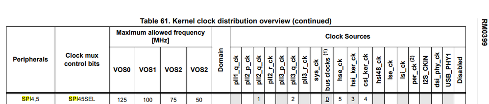

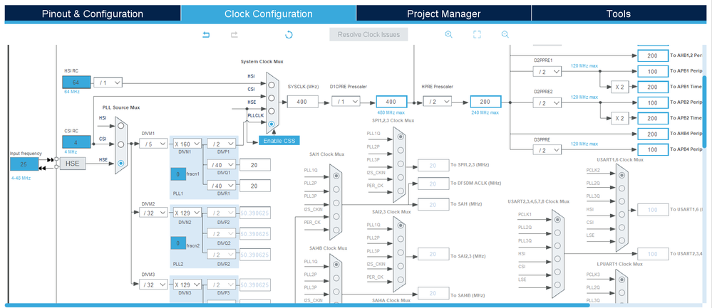

I am working on stm32h745 controller, I am configuring the DAC SPI . For the DAC minimum frequency is 80 MHz. I want to set that frequency for SPI4 , but uanble to set how I can set the 80 Mhz frequency to SPI4. How can I set that if I set the 120 MHZ clock to SPI , but in prescaler it get divided by 2 so it set 60 MHZ, How can I solve that,please help me0693W00000WI0IJQA1.png

Perhaps there's an audio, external or slave mode where you can provide the clock or use the PLL source?
Y​ou might need to use specific clocks to hit specific integer submultiples.

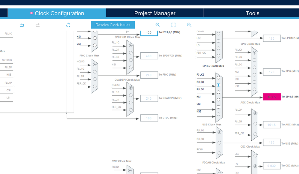

I tried it but getting the error0693W00000WI0UAQA1.png0693W00000WI0TlQAL.png
