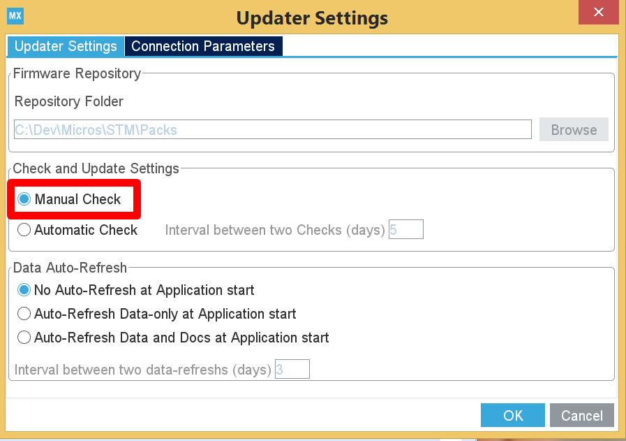

First one I turned OFF in Updater Settings to Manual Check (see screenshot)

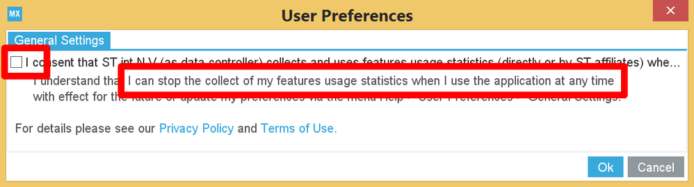

Second one is turned OFF in User Preferences (see screenshot)
So there should be no reason for CubeMX to tell anything to someone in internet or ask anything there. BUT CubeMX does not care and tries to do a LOT of connections in internet. WHY?
Every time I "Generate Code" it needs connection. Every time I create project - it needs connection. And all this with trurned usage collection turned off. Looks like spying ... NO?

What do you mean? Processor's families packs are installed for used families of micros (F3, F4). Updates are said to be manual. Data Auto-refresh is turned off. So from user point of view there should be no reasons for automatic requests of connection with internet in any case ... except of cause the case when CubeMX does not care about selected by user parameters :( ... or is simply spying :(. Both things are "not good" and should be changed I think

As I mentioned to yout previous message "Data Auto-refresh is turned off" on screenshot. So CubeMX should avoid doing this on "Application Stratup" update

You mean that you can buy from St privacy service in CubeMx!? If not then decribed "news" about something else are probably not applied to CubeMX. And moreover CubeMX clearly states that user "can stop collecting usage statistics" ... see screenshot.
