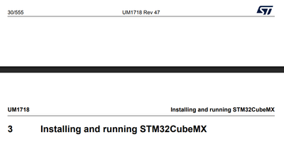

See the User Manual:
via: https://www.st.com/en/development-tools/stm32cubemx.html#documentation

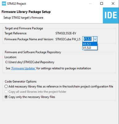

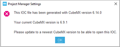

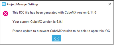

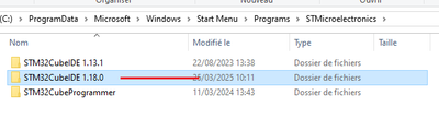

So why I have this picture :
However, I installed the latest version of STM32CubeIDE (1.18.0).Why ? I opened an .ioc file that someone gave me, is that probably why ?

When I try to create a Projet with STM32CubeIDE 1.18.0, I can see the available versions of CubeMX and I don't have the latest version of CubeMX
2025-03-25 6:37 AM
That's not the CubeMX version - that's the Firmware Package version.
