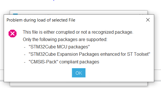

in https://www.st.com/content/st_com/en/products/embedded-software/mcu-mpu-embedded-software/stm32-embedded-software/stm32cube-mcu-mpu-packages/stm32cubef4.html there are the MCU package and the patch, the first can be installed from CUBE IDE with "manage embedded software packages" but when I select the second the tool says that is not a compatible file

Hi, I already had installed (using the "from local" option) the stm32cube_fw_f4_v1270.zip, but when I chose the patch (using the "from local" option) I got this error:0693W00000Su4XmQAJ.pngI just have downloaded both files using the "manage embedded software packages" and let cubeide automatically detects there is a new version (patch) and install it, now works
