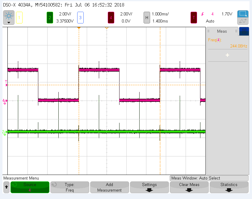

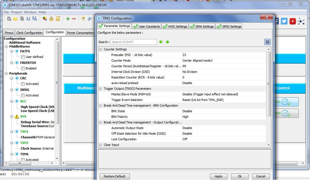

?,I have generated a project using STM32CubeMX tool (Used HW: STM32F030R8T6 on a Nucleo boad): PWM in center aligned mode on pin PA8 + I have toggled the PB1 pin at each update event (CNT = ARR & XNT = 0) in order to be sure that the center aligned mode is correctly generated.
Below is a screenshot of the result:
If you still encounter the problem, you may share your ioc file and I will check it.
