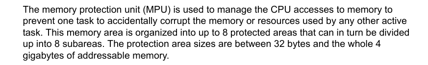

btw
Enable D-cache for some area or not is by setting the MPU , not the linker script.
Yes I know. But how to place a variable in exact RAM region (SRAM1 for example) if I don't have a properly defined sections in the linker script?
