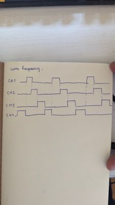

Just to clarify, channels 2 and 4 are the ones that shift channels 1 and 3 right? In other words, selecting the pulse on the "No Output" channels make the other channels go low on that instance of the duty cycle? I'm trying to configure 4 channels with the same frequency at different phase shift without any PWM overlapping (See Image).
