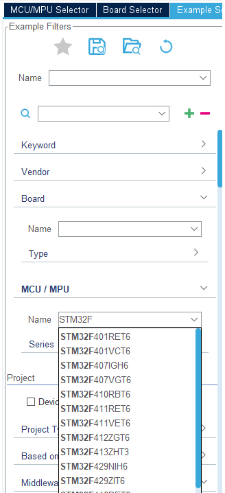

Could you tell me how to get some samples of STM32F103C8T6 in STM32CubeIDE?

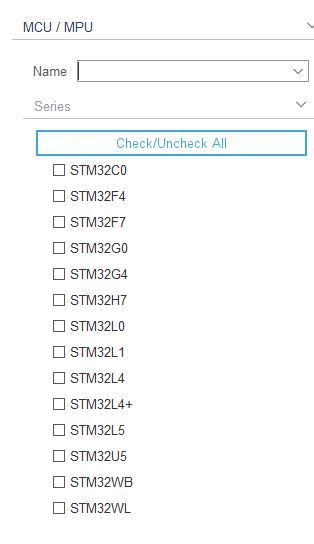

Hello @BLu.1 ,
The Examples are not available for all families.
Only the following series are supported:
Imen
