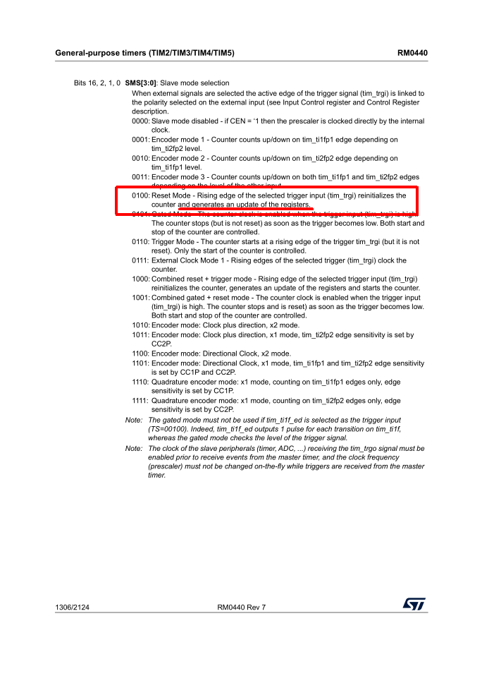

In particular, what you see are Update events as consequence of the Reset through slave-mode controller:

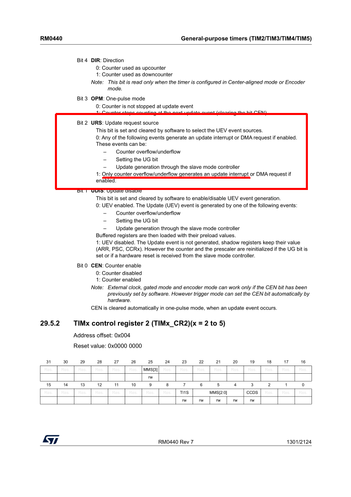

_legacyfs_online_stmicro_images_0693W00000dJyahQAC.pngAnd, knowing that, you can then separate this sorce of Update from the "genuine" Update due to overflow, by setting TIMx_CR1.URS:
