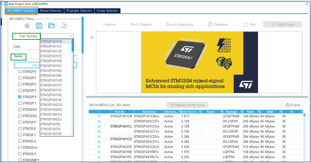

You can configure the STM32 chip through STM32CubeMX, first, you need to enter your exactly part number that will be used and press Start project:

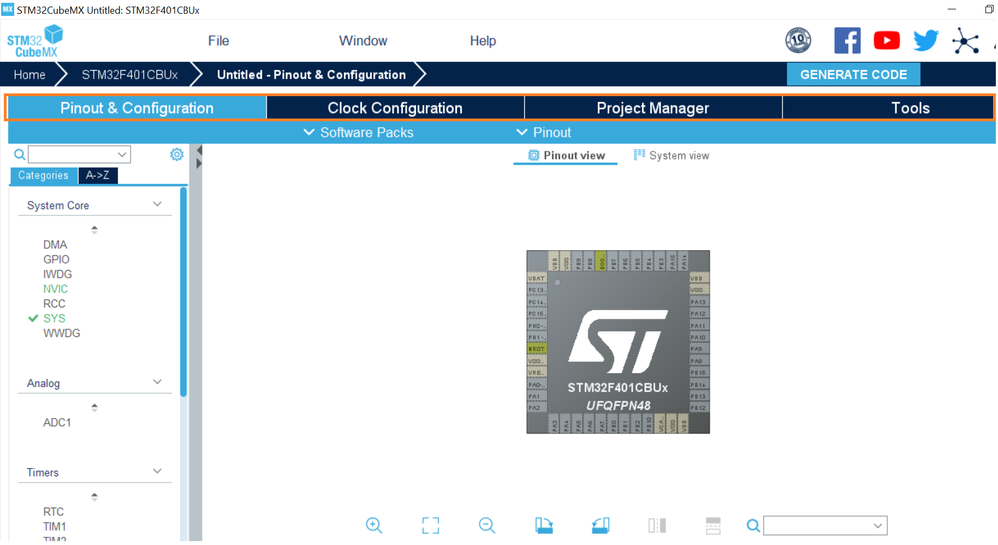

You can set/configure all the available peripherals, Clock and all the other options and parameters according to your need:

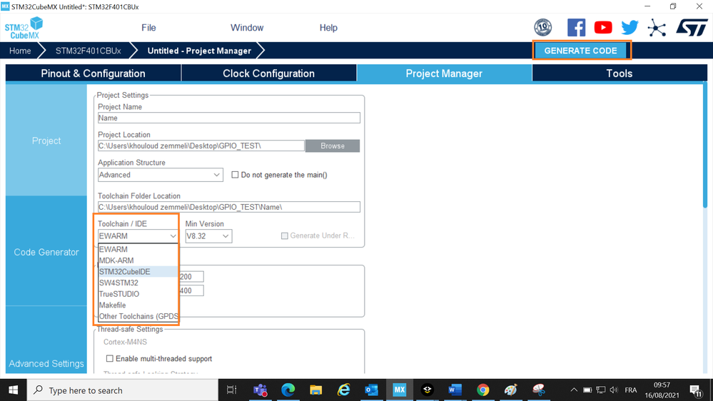

And then, you should choose the IDE to finally generate your configuration made in the previous step:
