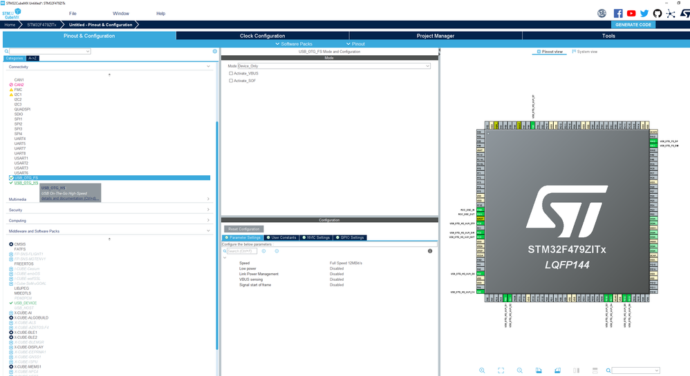

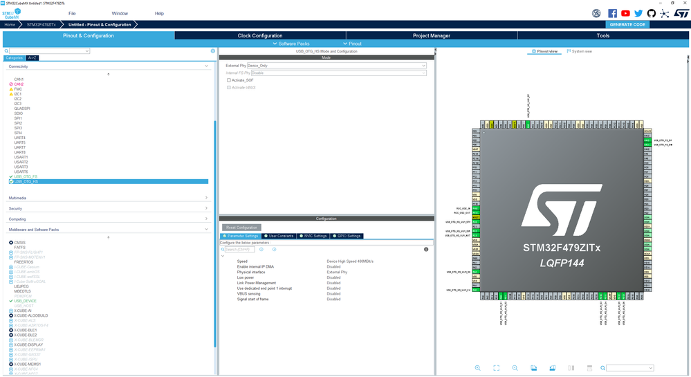

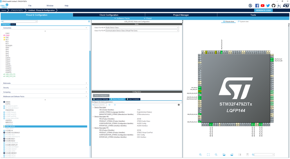

To create a USB composite device with CDC and UAC functionality, you can follow these general steps:
1- Select your target microcontroller model (e.g., STM32F479ZITx)
2- Enable the USB_OTG_FS and USB_OTG_HS by navigating to the "Connectivity" tab .
3- In the "Class For FS IP" section, select "Communication Device Class (Virtual Port)" to enable CDC functionality.
In the "Class For HS IP" section, select "Audio Class" to enable UAC functionality.
4- Configure the other settings, such as endpoints, buffer sizes, and callbacks, as needed for your application.
5- Configure the clock settings and other peripheral configurations as per your project requirements.
6- Generate the initialization code using STM32CubeMX and export the project for your chosen toolchain (e.g., STM32CubeIDE).

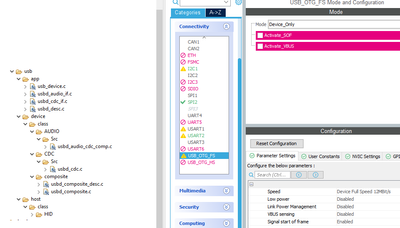

I have to say that looks like a real hack, back in 2015 it was possible to set the F407 up with Audio, Virtual com port devices, and host for keyboard and mouse, as you can see in the diagram.
It looks like STM is losing the ability to support their MCUs.
2023-09-23 5:19 PM
What you're asking for was available for the F407 in 2015, I have the code for doing this as you can see in this image.
STM seem to have dropped the ball on USB, it really seems like they are in a mess. They've told me that they are focusing on USB for AzRTOS, and hope to have it working by Xmas, but like you, I'd prefer to have it working as it did back in 2015 but for the H7 in my case.

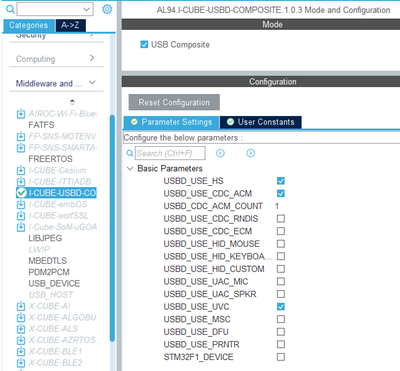

it is a shame that CubeMX does not support a combination of several device classes. After one day of searching examples i found a "software pack" for CubeMX:
alambe94/I-CUBE-USBD-Composite: Create STM32 USB Composite devices with ease. (github.com)
ST, please support this project and promote it, so we all can save lifetime!
I use:
CubeMX 6.10.0
CubeIDE 1.14.0
Processor: STM32F407VGT
