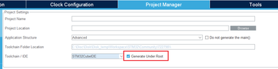

Hi, I would like to separate the project files (.project) and source files into different directories as shown in the image below. How can I do this?
In my original project, I don't want my source files and project files (.project) to exist in the same folder, as shown below.

Before generating a project using STM32CubeIDE you need to uncheck the check box "Generate Under Root":
Hope it answers your question.
