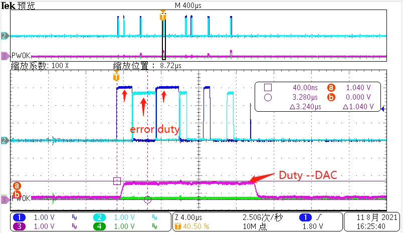

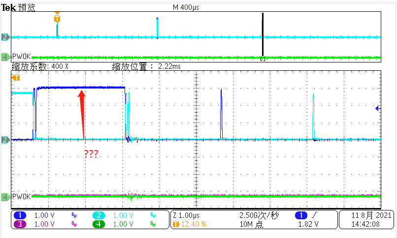

How to configure the STM32G4 HRTIM to control a half-bridge LLC converter with synchronous rectification?
Please check my ico and code,What is wrong with my configuration?
TIMA and TIMB must be updated simultaneously with the master timer repetition event.
2 REPLIES 2
JGrap.1
Associate III
My configuration is using 'Reset Trigger' instead of 'Update Trigger'.
JGrap.1
Associate III
and I also enable Repetition Update for both TIM.
This's work for me. hope it help you. too.
