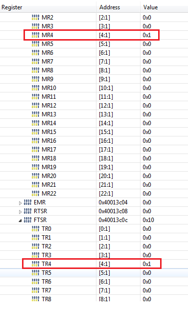

I know that this is an old thread, but I have an identical need - that is, have an external interrupt on the MISO line while the SPI is enabled.
Here are a few code snippets from what I have, but for some reason, I cannot get the external interrupt to trigger.
The processor is an STM32F407.
The interrupt is connected to the MISO line (PB4).
The interrupt is to be negative edge triggered.
// Configure PB4 (EXTI4) for falling edge trigger
// Enable EXTI4 interrupt in NVIC, but don't enable
// the local ISR enable until we are ready.
EXTI->FTSR |= EXTI_FTSR_TR4;
NVIC_EnableIRQ(EXTI4_IRQn);//*******************************************
// Enable global interrupts
__enable_irq(); //*******************************
// Enable external ISR on PB4
EXTI->IMR |= EXTI_IMR_MR4;Looking into the EXTI registers, I see that the interrupt is enabled, and falling edge triggered.
Of course, I am not using HAL. I don't trust him - you know why.
What am I missing here ?
Thanks in advance.
2021-11-08 10:33 PM
You have to select the proper port in SYSCFG_EXTICR.
