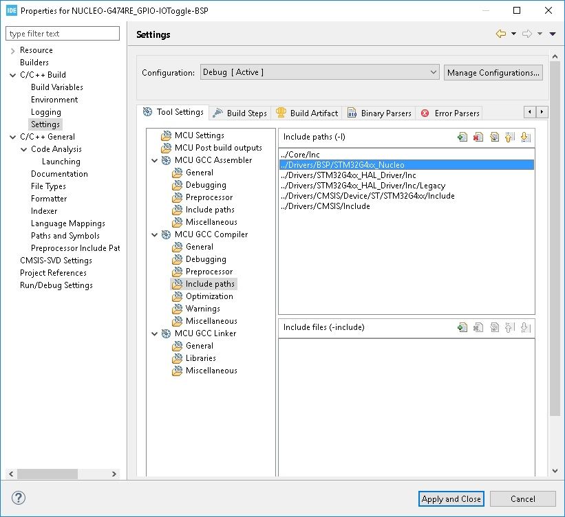

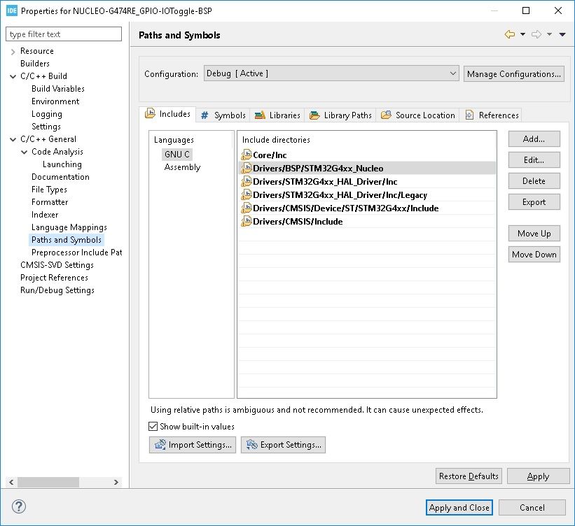

2020-08-06 6:43 PM
You may still need to add it in the GCC compiler include path
and check if added in path and symbols
