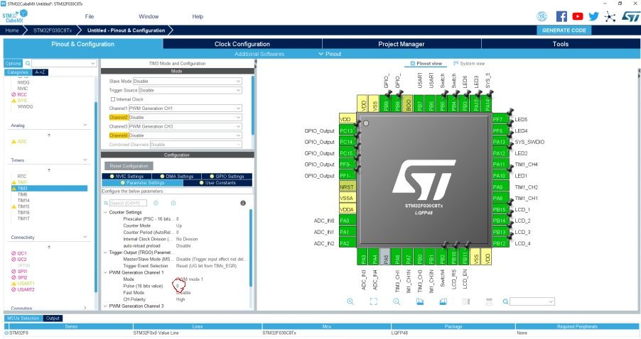

Please tell me how this pulse value is used in the TIM->PWM Generation CHx.
How this value effect the Pwm generation.

Generate the code, then look into the code including Cube sources, to find out what registers in timer are affected. Probably the relatated TIMx_CCRy.

sConfigOC.Pulse = 10;
This is the configurations occurs after generating the code.

Now look into the HAL timer config function that you call and see what it does with the sConfigOC.Pulse value.

uint32_t Pulse; /*!< Specifies the pulse value to be loaded into the Capture Compare Register.
This parameter can be a number between Min_Data = 0x0000 and Max_Data = 0xFFFF */
This is the details i found there.
I have a confusion that the timer will reload from ARR register than where this pulse value effect the PWM signal generating from the timer.
I had done the following configuration but i am not able to judge the pulse value
clock=48Mhz
Prescaler=24
ARR=100
Please let me know what i have to do with this pulse value.
2019-08-01 9:07 AM
Well, you've found out that the pulse value is loaded into the Capture Compare Register (TIM_CCRx). Reading the timer chapter in Reference Manual certainly reveals details on what is the purpose of this register.
