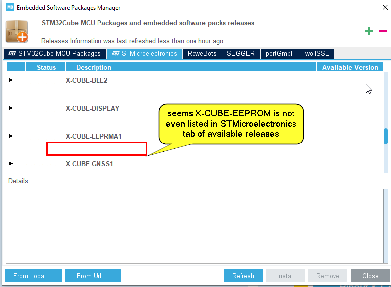

I would like to use the X-CUBE-EEPROM product

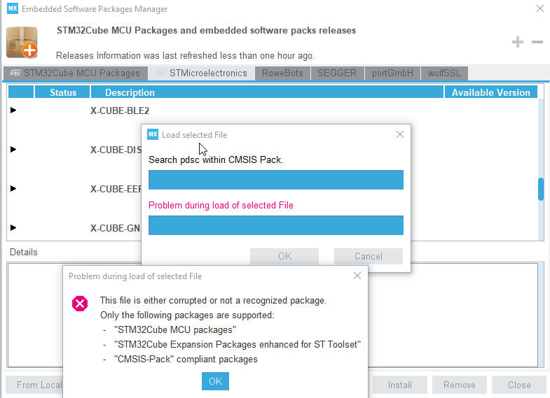

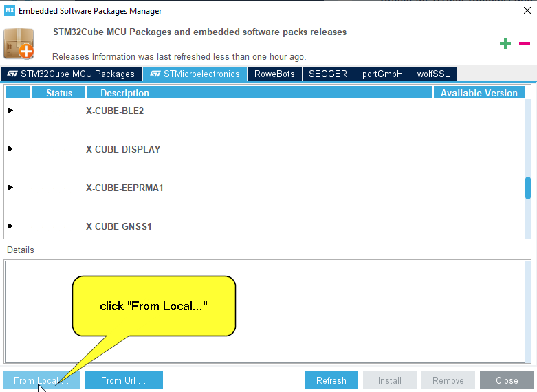

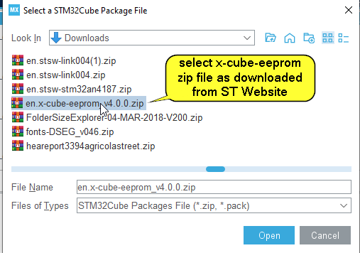

Here is the message I get when I try to manually install the downloaded expansion pack (from this link) using the Embedded Software Packages Manager and the From Local... Button:
What can I do?

You have mixed up the software packages and downloaded/tried to install the wrong one:
Good luck!
