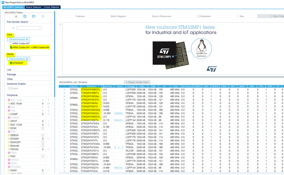

2019-06-24 7:27 AM
Open CubeMX - Select " Access to MCU selector" then:
