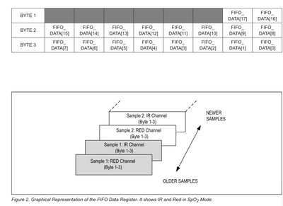

When reading the FIFO buffer though I2C read command, we typically retrieve 6 bytes of data: 3 bytes for the Red LED value and 3 bytes for the IR LED value.
The question is: how is the data arranged in the 6-byte buffer?
Is it organized such that bytes 0 to 2 represent the Red LED data, and bytes 3 to 5 represent the IR LED data?
I'm a bit confused about how the data is arranged when reading multiple bytes. Could you clarify the orientation of the data in the buffer?
