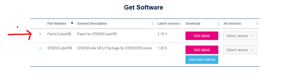

Quick question do need to install the Patch for STM32CubeWB?
2024-08-13 7:46 AM
No need to install the patch. You just have to download the Version 1.20.0 and add it to CubeMX as mentioned on the User manual that I've shared with you.
If you are going to use another MCU, you will need to add his Cube Package (an STM32Cubexx for each STM32xx MCU).
