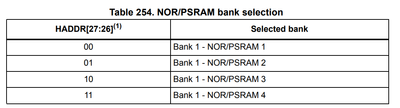

Thanks to answer, but, my problem is configuration NE2 and NE3 occur is problem to conflict. Also, problem is to configuration Bank, I'm configuration Bank1 but, cubemx be generated to code bank 3. What is the problme ?

I am using STM32F407ZGT6 but I am looking to see what my problem is. I didn't see separate fields for NAND flash configuration. Now everything is final with the settings. Thanks a lot to answer!

--> I'm configuration Bank1 but, cubemx be generated to code bank 3
I made some test using STM32F407ZGT6 and STM32CubeMX 6.8.1 and I don't found any issue.
However, this command line indicates that Bank 1 - NOR/PSRAM 3 is configurated not bank 3 .
hsram1.Init.NSBank = FSMC_NORSRAM_BANK3;
For more explanation please refer to RM0090 and precisely table 254
Thank you.
