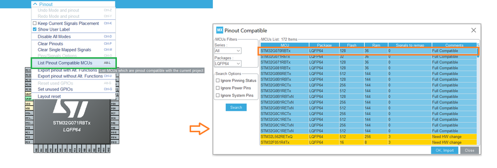

The answer is Yes, it's possible to import your project basically created with G071R8 on G071RB using CubeMX.
I present to you, as mentioned in the image below, a ways which allows you to know the MCUs that are compatible with each other even with different Flash sizes and all this through CubeMX =) :
0693W000007DxK9QAK.pngThanks, Khouloud

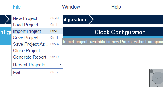

Hello @Bernd Heißwolf​ ,
Using STM32ubeMX, what could be possible is to create a new project on STM32G071RB and from this blank project,
import the configuration from your STM32G071R8 project,
you will still need nevertheless to port after that the application part into the new project.
