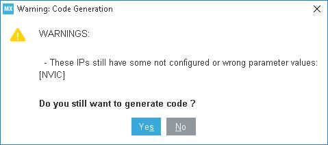

Click no and check the System Core NVIC tab for warning or error icons. Place the mouse at those icons to see some helpful text.

Hello @JJarr.1
Can you please share your ioc file to check more the source of your problem ?
