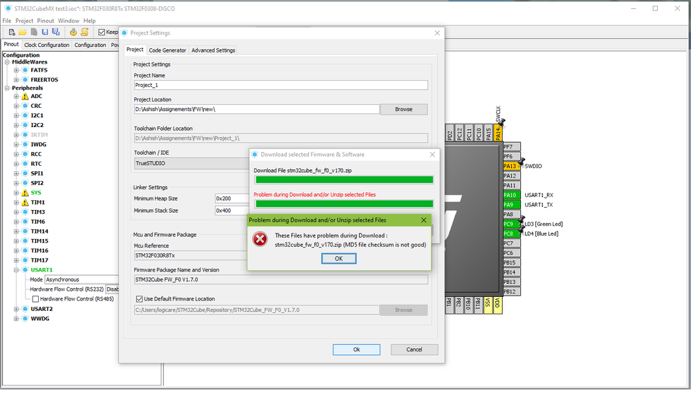

I am using the cube version 4.20.1
STM32Cube V1.0
When i am using new latest Cube IDE in that this board is not showing in the list
Kindly suggest which IDE will have this board compatibility !!!!!!

In your screen shot, find the folder path under "Use default firmware location". The firmware .zip file in that folder causes the error. Probably broken during download. Navigate to that folder, delete the menitoned file and try again. If this doesn't work, change download folder to a different folder, and try again. Good luck for your assignments!

Thank You KnarfB!! It worked after removing the old file.
