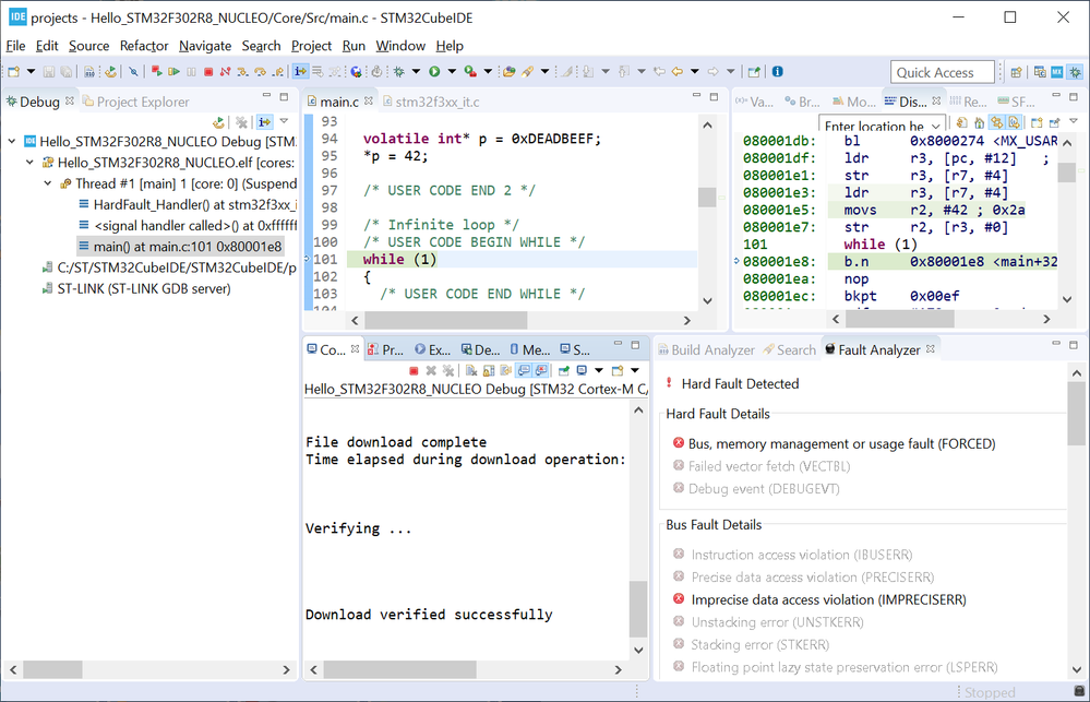

Depends on your toolchain. In CubeIDE it could look like:
left. You can walk up the call stack and find out the cause. In the example this is the machine instruction
080001e7:   str     r2, [r3, #0]
generated from the C code line
*p = 42;

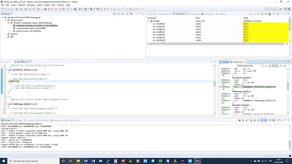

0693W000000UIqKQAW.jpgok, this is my debug window , what should I do now?
sorry but how do you kow that the cause is this?
and the c code line is this?
    *p = 42;
In the debug view click on main(). This will put you to the source code line.
The fault analyzer window says its an data access fault. So I'm looking fo the last load or store instruction before the current (fault handler) instruction.
Its also an imprecise fault, so it is caused by the write buffer (store).

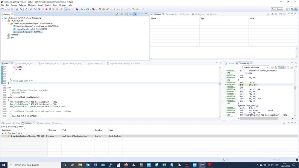

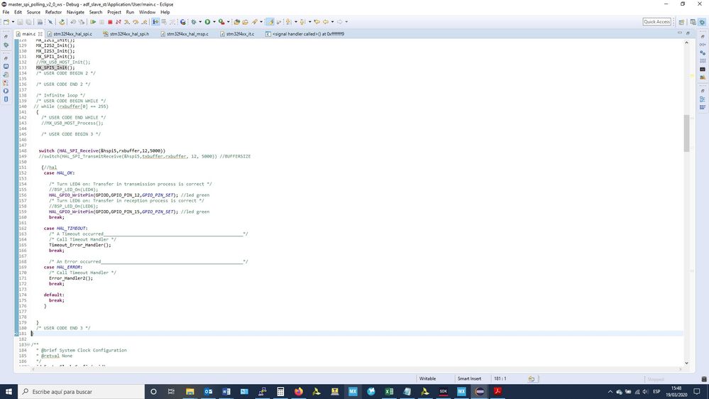

I select main indebug view and shows me this line
but that line is the end of this part of the code, there is nothing declared there
I am using SW4STM32 and it seems that it does not have a fault analyzer window
Go single step by single step though your code and watch when its crashing. Can even go single step at instruction level if you dare to.
