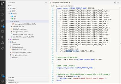

Apologies for the late reply. I was able to recreate the issue by creating a new project for the STM32H7, going to project manager, entering a project name and location, selecting CMake for the toolchain/IDE, and generating the code. The result is a generated Core/startup directory (lowercase s in startup), while the `mx-generated.cmake` uses Core/Startup (capital S in startup). See below:
