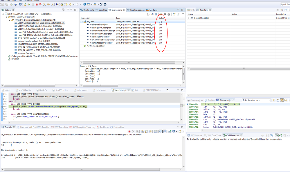

Hi, I'm installing USB VCP communication, I generated the project with CubeMx, my board is configured as a device and I loaded the virtual com port as a Class for FS IP.
It happens that by compiling the program with GCC (True Studio) the "FS_Desc" structure is not loaded into ram (all pointers are at 0) and consequently when trying to use this structure the program crashes (Hard Fault).
The same program compiled with Keil works perfectly ...
Does anyone have any idea what happens?
I attach the True Studio screenshot with the breakpoint where the crash occurs.

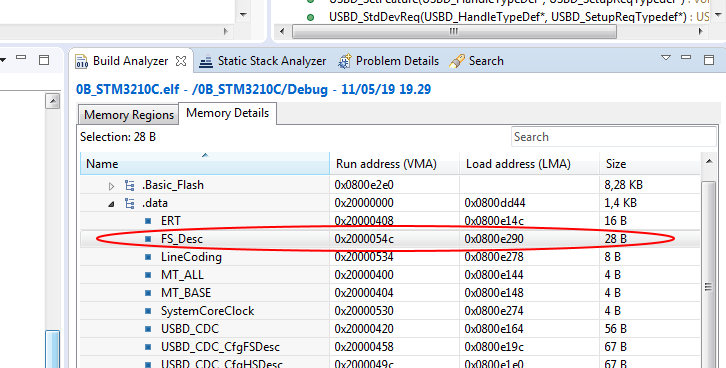

I found the problem, it is a misalignment between LMA, VMA
and loader, in fact I introduced in the linker script (.ld) an offset of 0x400 bytes and this can be seen in the screenshot where the initial VMA address for .data is 0x20000000 but the address of the first variable (ERT) is at 0x20000408.
However, the loader does not see this offset and only loads 0.4kb in area 0x20000000 ... 0x20000190, leaving all the structures from ERT forward uninitialized.
What I need to do now is instruct the loader that the initial address for the structures to load is 0x20000400 instead of 0x20000000.
