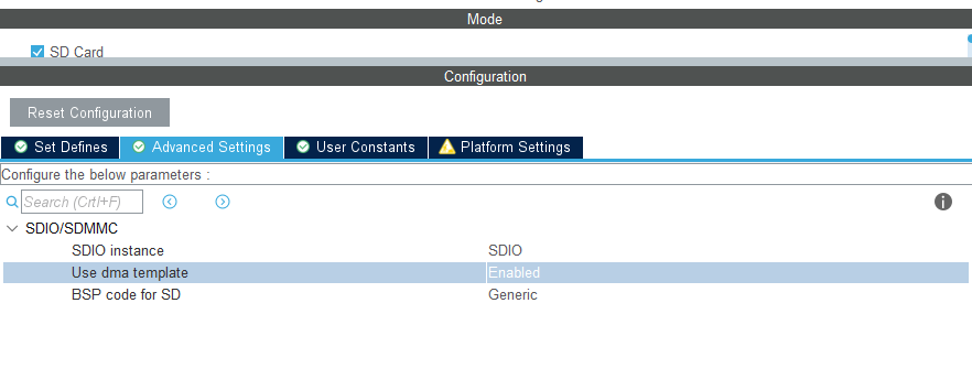

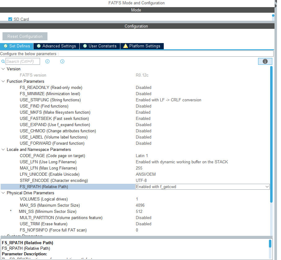

hello, ı want to communicate sccard via sdio with fatfs . in while loop and before while my code is working. but my code is not working timer callback and gpio external callback. this error is fr_disk_error or fr_no_filesystem. ı searched everything but happened.
cube Version: 1.5.1
may you help me pleas. how to solve this error (return = fr_no_filesystem)
thank you advance
Hi dear Ayuks,
Actually Timer's callback is not a good place for doing something like that. You can set a Flag as well and use it in main loop. I think you're doing great.
About why did you get those Error I have no idea. If it's important to you, you can easily debug that with your own and see what's going on there.
In addition, when you get those Error you can re-initial the fatfs and make it to work. You can try re-initial for tens of times to get FR_OK.
