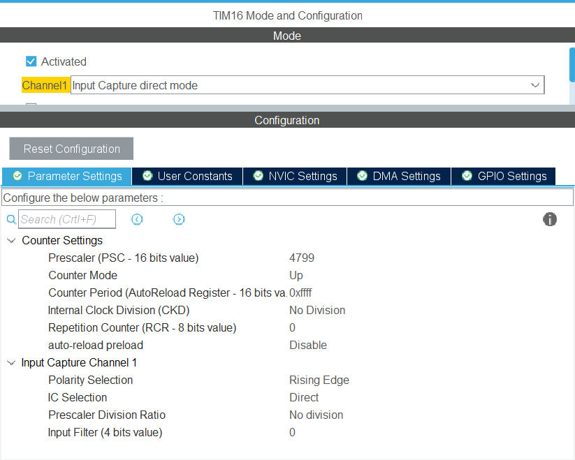

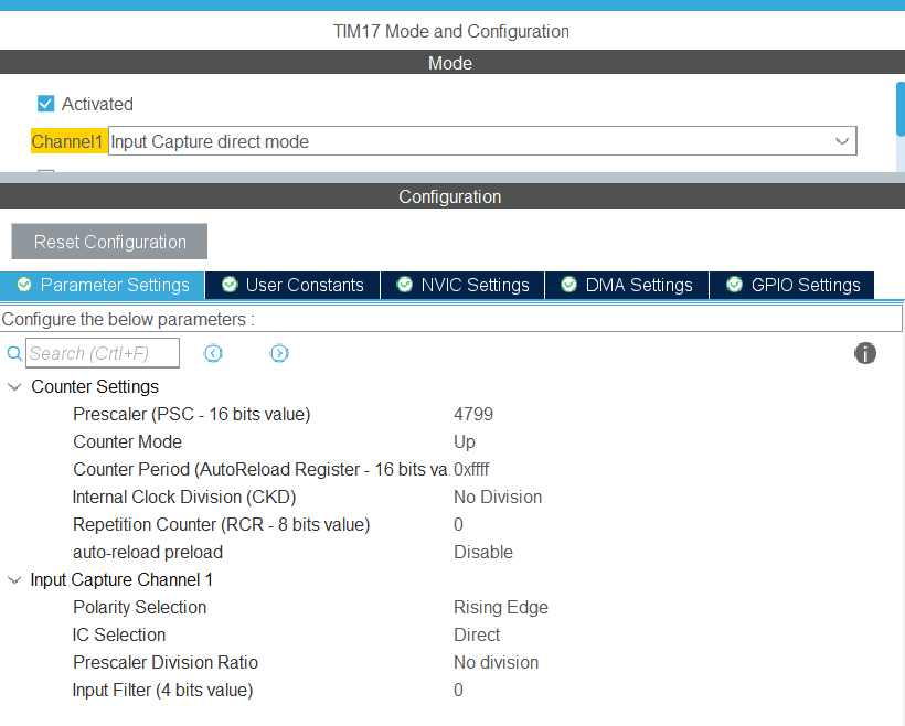

Method - Input Capture
First I enable the input capture with this code.
volatile static uint16_t input_capture0[2] = {0};
volatile static uint16_t input_capture1[2] = {0};
void STM32_PLC_Start_Input_Capture(TIM_HandleTypeDef* htim17, TIM_HandleTypeDef* htim16) {
	 * Input capture for measuring frequency
	 * For TIM17 and TIM16
	 * Timer clock: 48 Mhz
	 * Prescaler: 4799
	 * Counter: 65535 (0xffff)
	 * Update frequency: 0.1526 Hz (1/0.1526 = 6.5535 seconds)
	 * Example: For every second, it will count 10000
	 * Lowest frequency measurement: 1/(0xFFFF*0.0001) = 0.1526 Hz
	 * Highest frequency measurement: 1/(1*0.0001) = 10000 Hz

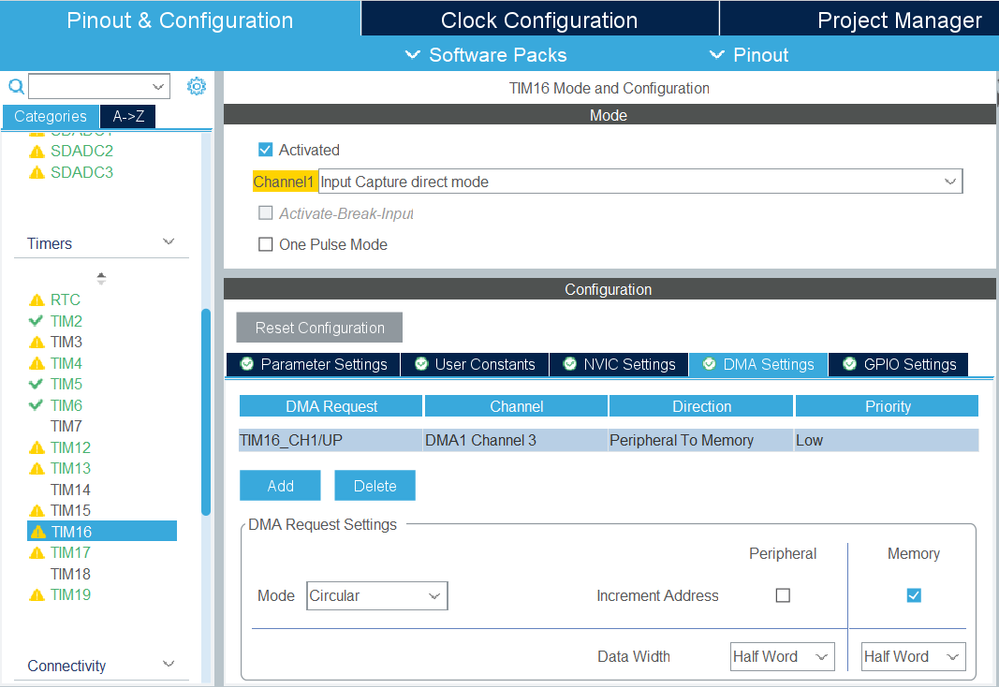

	if(HAL_TIM_IC_Start_DMA(htim16, TIM_CHANNEL_1, (uint32_t*)input_capture1, 2) != HAL_OK)
		Error_Handler();

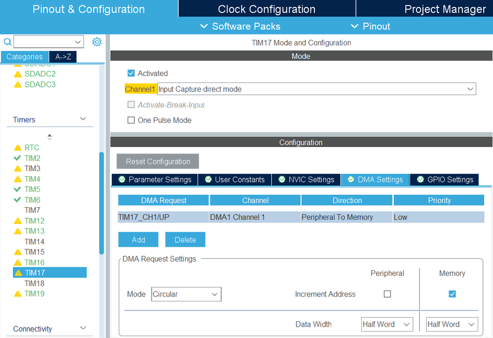

	if(HAL_TIM_IC_Start_DMA(htim17, TIM_CHANNEL_1, (uint32_t*)input_capture0, 2) != HAL_OK)
		Error_Handler();
They both DMA are for circular modes.
0693W00000D2UKvQAN.png0693W00000D2ULFQA3.pngThe purpose with the arrays above, is that I can compute the freqeuency by calling the function

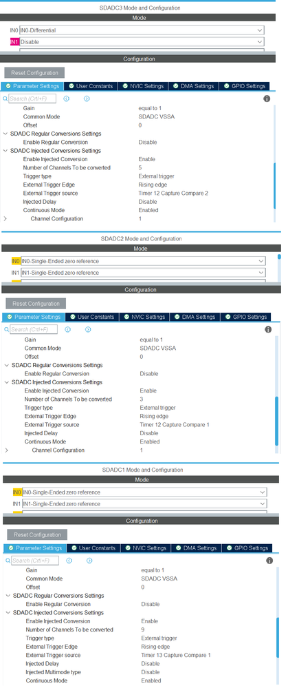

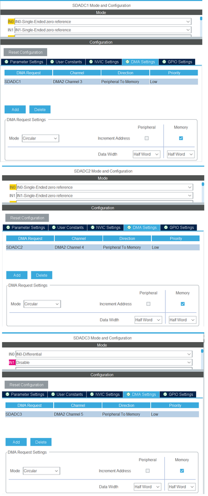

Here is DMA configurations for SDADC1, SDADC2 and SDADC3.0693W00000D2UMrQAN.pngI have also selected Injected Conversion and using a timer for calling the SDADC function.

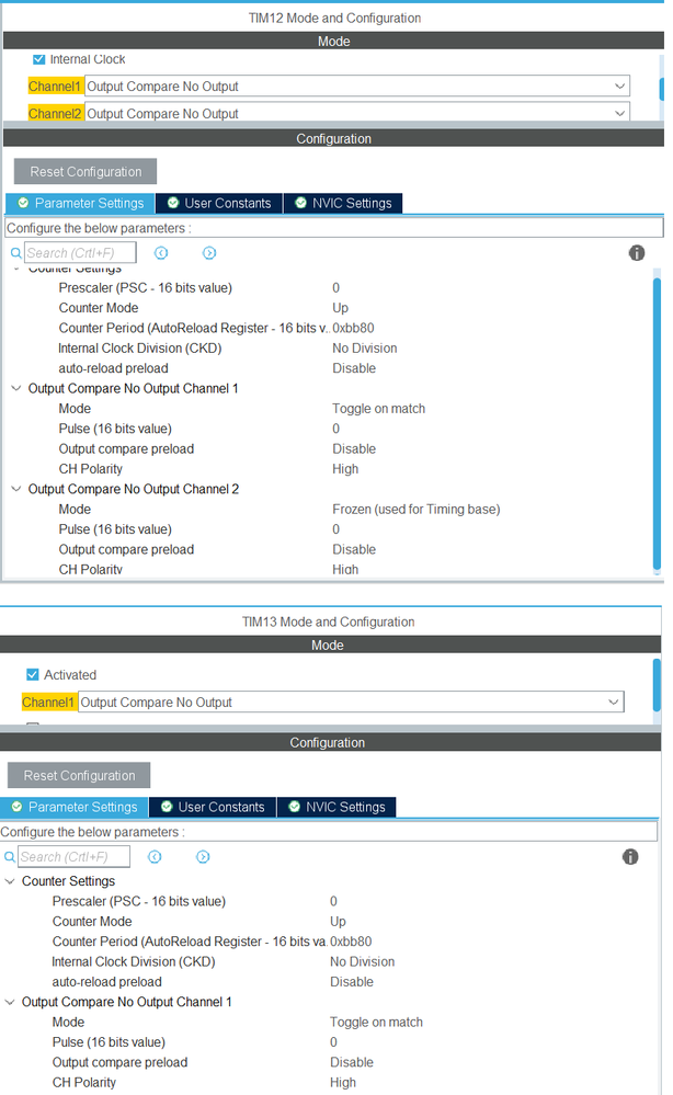

0693W00000D2UMwQAN.pngAnd the timers TIM12 and TIM13 for SDADC.
0693W00000D2UNGQA3.pngI also can change gain on the Sigma Delta ADC while the STM32 processor is running.

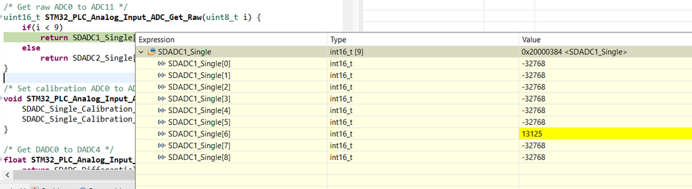

Result - Input Capture
These arrays gets different values when the STM32 processor runs.
I can read them, but ONLY input_capture0 (TIM17) get updates values. ONLY input_capture1 (TIM16) get values once, then nothing happens any more.

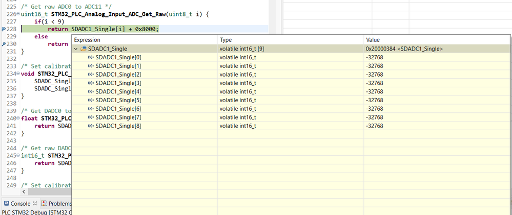

This results:
  • Input Capture + DMA works
  • SDADC + DMA works, but I only get -0x8000 = -32768 (int16_t) because all my inputs are attached to GND. It seems that even if I have circular buffer, it still acts like it's Normal Mode. I can't change these values if I apply higher voltage onto the SDADC inputs. Hm...

Hi!
I found a solution for Input Capture. It's a bug inside STM32CubeIDE 1.7.0.
Solution:
Move MX_DMA_Init();
  MX_GPIO_Init();
  MX_DMA_Init(); <--- To here
  MX_DAC1_Init();
  MX_DAC2_Init();
  MX_RTC_Init();
  MX_SPI2_Init();
  MX_TIM2_Init();
  MX_TIM5_Init();
  MX_SPI1_Init();
  MX_TIM4_Init();
  MX_SDADC1_Init();
  MX_SDADC2_Init();
  MX_SDADC3_Init();
  MX_CAN_Init();
  MX_USART1_UART_Init();
  MX_TIM6_Init();
  MX_TIM12_Init();
  MX_TIM13_Init();
  MX_TIM16_Init();
  MX_USB_DEVICE_Init();
  MX_FATFS_Init();
  MX_TIM17_Init();
  <--- From here
  MX_TIM19_Init();
  /* USER CODE BEGIN 2 */
This results:
STM32MP151AAC3 custom board with STM32-OS as operating system: https://github.com/DanielMartensson/STM32-Computer
STM32MP257FAK3 custom board with STM64-OS as operating system: https://github.com/DanielMartensson/STM64-Computer
I found a solution to the SDADC arrays.
Don't use the volatile keyword. That causing problems. Is that a bug too?
Now I get values when I apply voltage to the SDADC inputs.
