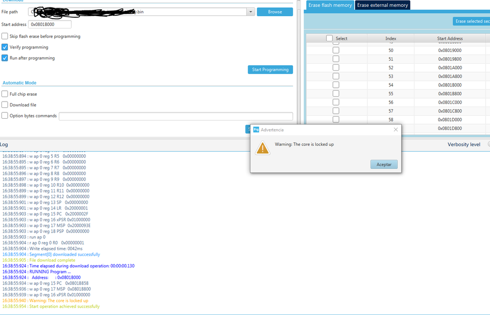

Good evening stm32 dwellings, i have a flash problem.
I find myself with the need to write a config file independent to my programm code.
In order to do that my programm uses pointers to specific memory pages of my stm32f105:
define ADDR_FLASH_PAGE_54 ((uint32_t)0x0801B000) /* Base @ of Page 54, 2 Kbytes */
#define ADDR_FLASH_PAGE_55 ((uint32_t)0x0801B800) /* Base @ of Page 55, 2 Kbytes */For debugging purposes i created a temporal setup function that writes the a hardcoded config structure directly to my flash. (<- this is working fine, reading and writting)
BUT
Once i build my own configFile.bin and try to flash it with stm32cubeMX i get this:
the flashed data looks fine when i read the memory, but the mcu is locked, once i start a debugging session it goes into hardfault at random moments.
this is the verbosity output of the stm32cubeMX flashing
I have no idea of what is going on....

16:38:55:940 : Warning: The core is locked up
16:38:55:954 : Start operation achieved successfullyExtra ball: if i do full chip erase and then i flash again my small config file at start address 0x0801B000 i also get the Warning: The core is locked up
2023-04-24 3:20 PM
I did overcome this issue purely by ignoring It.
I Believe the core is locked Up message showed Up because cubeprogrammer was tryingto run the binary file right after flashing.
As It was just raw config data not compiled Code , thus it was crashing
