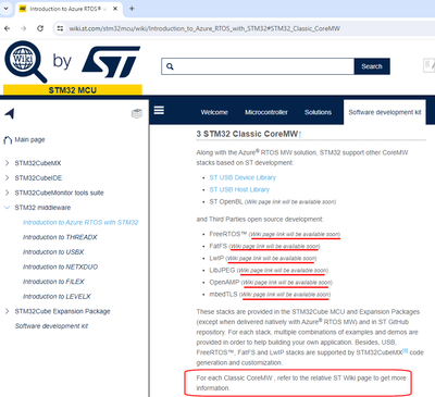

Following the FAQ link from that page, I got to this:
It's not very helpful to say, "refer to the relative ST Wiki page to get more information" when none of those Wiki pages exists!
