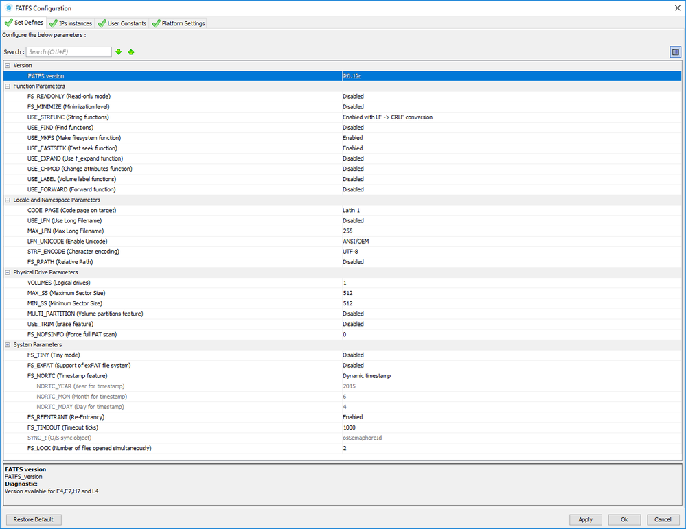

I am using STM32L476VG and I want to write files to a SD card. In CubeMX I generate code for the FAT File System with the following settings:

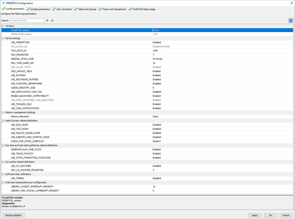

Moreover, I am using FreeRTOS with static memory allocation only:

2. For some reason the setting for USE_LFN (Use Long Filename) is not accepted for code generation. This setting is disabled in CubeMX (see first screenshot) but in ffconf_template.h the lines
#define _USE_LFN 3
#define _MAX_LFN 255
