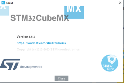

I started the upgrade process as always under administrator rights, the download and installation finished successfully and then I need to restart with administrator rights again to fulfil the installation and I get this:
I close all the other application, I even restart the PC but still I get this.

Hello @Egolt.1
I am not able to reproduce the described behavior with my PC.
It seems like you have an issue with access rights.
However, could you provide these details which could help us help you:
KR,
Semer.

Hello @Egolt.1
I made a second update using the 6.6.1 version and it also was successful.
I believe that the issue is related to some access right with Windows.
The only solution I propose at this stage is to download the STM32CubeMX 6.9.0 from st.com and make the install.
