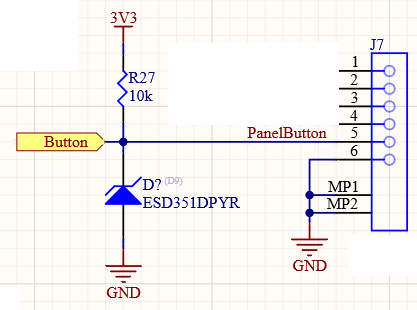

The schematic for that pin is very simple (one pull-up and a protection diode, Button is connected to PE2) :

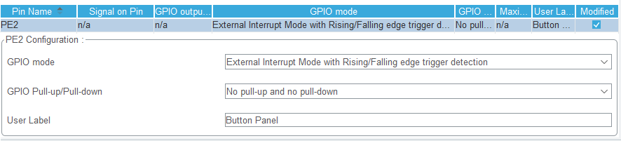

I am using STM32CubeMx to generate all the necessary code :

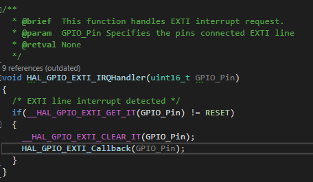

I also made sure that the interrupt is being cleared, this is done in the CubeMx generated code in the function HAL_GPIO_EXTI_IRQHandler :

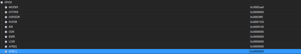

Read out and post content of GPIO registers.

Here is the status of the GPIOE when entering the HAL_GPIO_EXTI_Callback() function :

2020-04-21 3:24 AM
MODER for PE2 is 0b10 i.e. AF, and AFR[0] is 0, i.e. it's set to TRACECLK.
It oscillates, so you see a "mid-value" using a multimeter.
> As for as I know trace is not enabled :
Maybe the mechanism to enable it is somewhere else in your IDE than you've looked.
