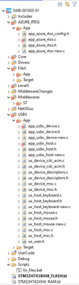

What I do is create a separate file with the "SameName-new.c". Then after reconfiguring the CubeMx configuration, i run a script and it restores my code automatically. After the reconfiguration, the file tree looks like: The files with the Red marker are the ones that CubeMX modified.
I can run a diff or compare the CubeMx ver to my version; or if it is just a simple define change, I can quickly restore my code by running the scripts/fix_files.bat.
The script file is a simple .bat file which removes the CubeMx files that are not needed.
This made my life a lot easier
