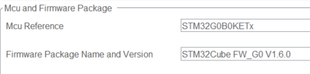

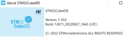

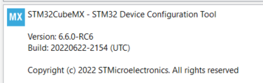

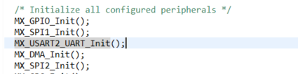

2022-07-05 2:32 AM
I'm sorry but that doesn't works for me, i have updated cubeIDE to 1.10.0 to have CubeMX 6.6.0 and CubeFW_1.6.0, forced by the new version :( ...
After generation, i still have the error, USART is initialized before DMA !!
Thanks,
Thomas.
2022-07-15 7:22 AM
Hello @tvill.1 ,
The issue is fixed in v6.6.0, only H7 devices still have it. Anyways when migrating a project with a wrong order it doesn't get fixed automatically, you have to correct it before project migration, even if you didn't you can apply the workaround (before or after project migration) proposed in this thread MX_DMA_Init order in the main.c file generated by STM32CubeMX, How to fix?
