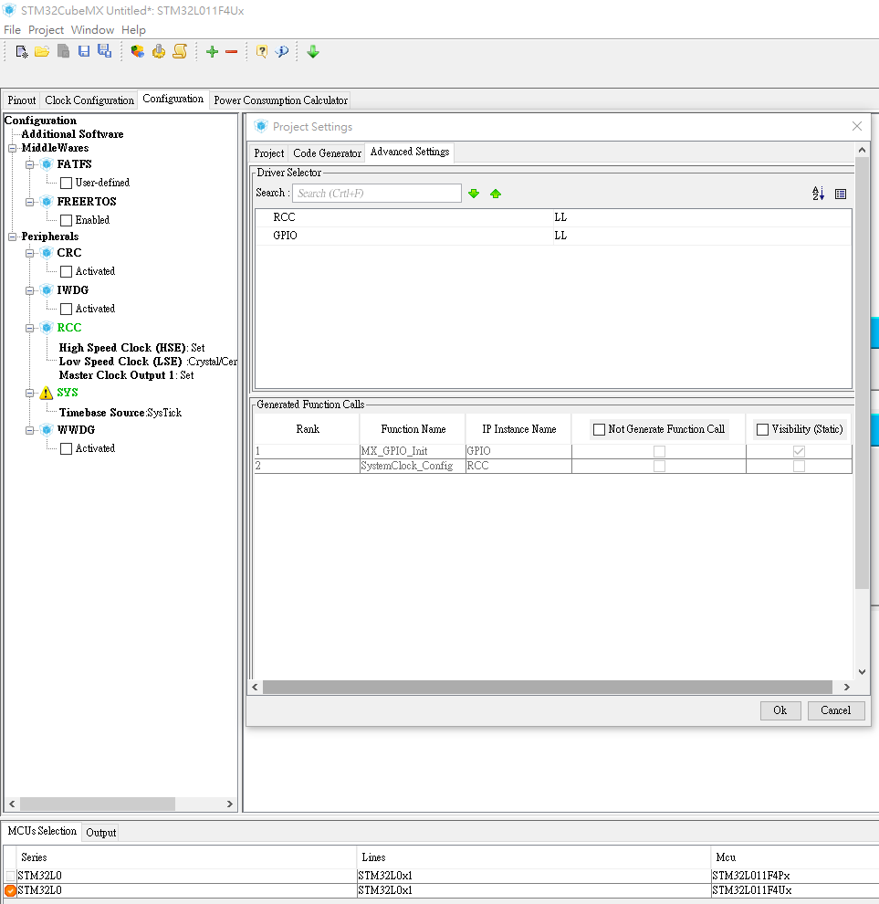

Did you click "Advanced Settings" on the left like I suggested? It works, I tried it. Make sure you have the latest STM32L0 package.

Yes. Change from HAL to LL in the "Project Manager" -> "Advanced Settings" tab.

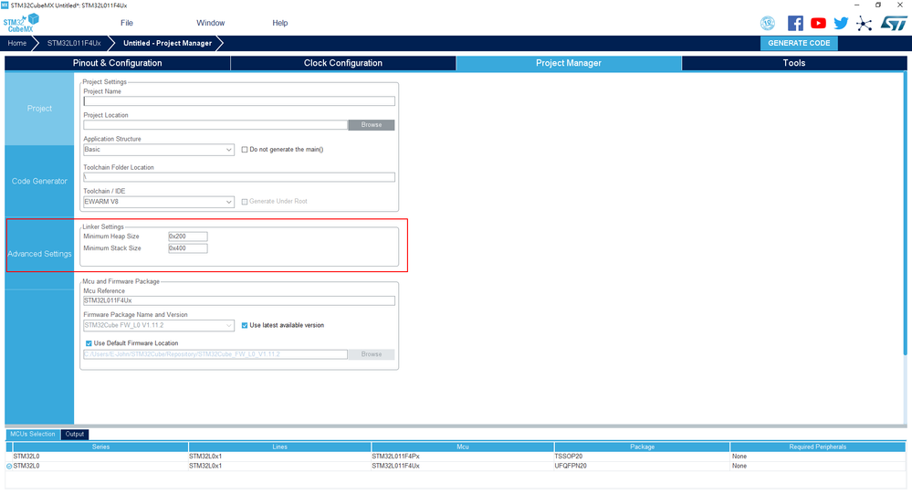

Hi TDK,
There is no option for switch "HAL/LL" on "Project Manager"->"Advanced Settings" tab of STM32CubeMX 5.3.0, see picture below
Is there any missing?

On the left side, there are 3 tabs. You have the "Project" tab selected. Click on "Advanced Settings".
Yes, the UI is horrible.

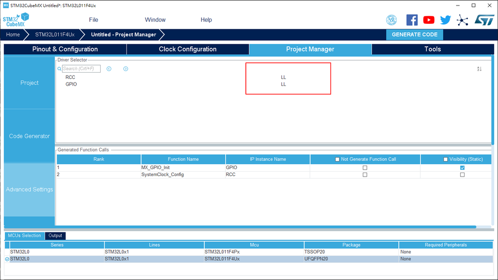

Hi TDK,
STM32CubeMX V4.27.0 is the last version I found that supports LL. see picture blow.
2019-10-13 7:51 PM
Hi TDK,
Yes, the different setting page appears after clicking the "Advanced Settings", like below.
