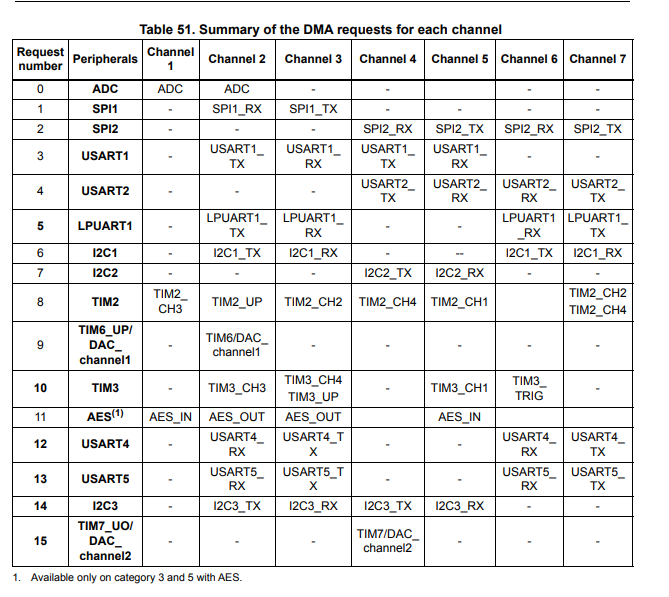

2019-05-10 5:12 AM
You can do the configuration according to the mapping.
Look at this table: Summary of the DMA requests for each channel
Best regards,
Nesrine.
