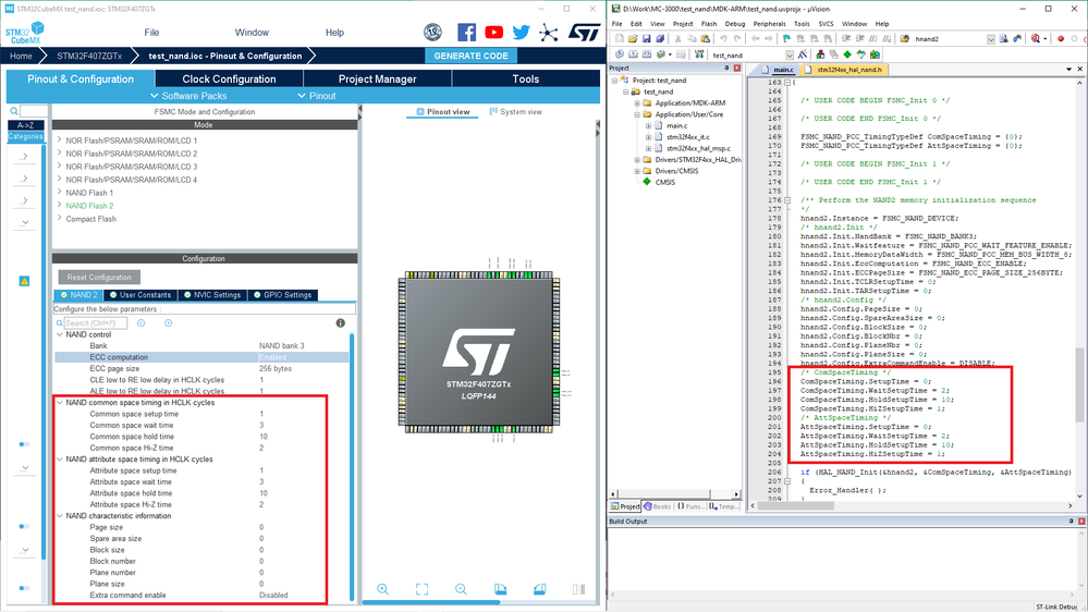

Hello my friends, why is not generated setup from CubeMx for my Keil, why is distinguish setup ?

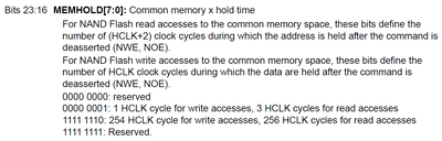

In the register fields that control these timings, a value of 0 means 1 HCLK cycle, hence the difference of 1.
Except for MEMHOLD which is the same:

2023-08-03 5:24 AM
Thanks a lot, this is user manual cubemx?
2023-08-03 6:11 AM
This is from a reference manual for the STM32F4 series.
