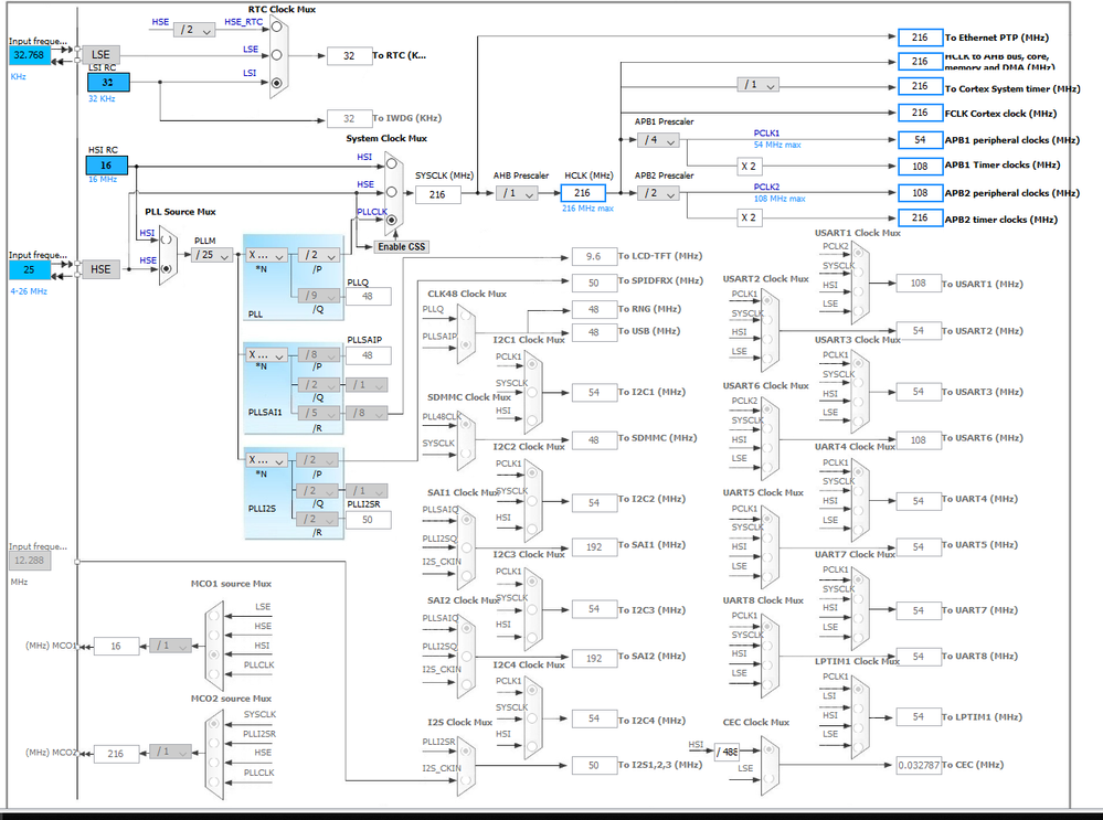

Hello, im generating default ethernet codes from CubeMX. im using freertos+lwip and i set static ip. All other lwip settings are default. My clock config:

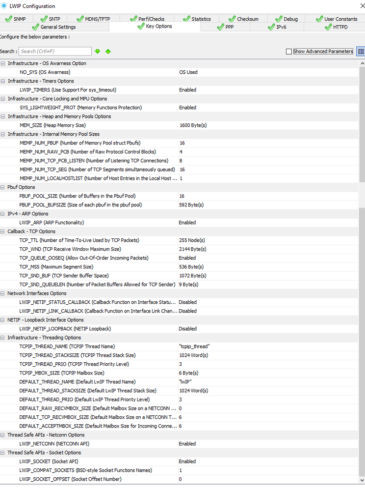

My default lwIP settings:

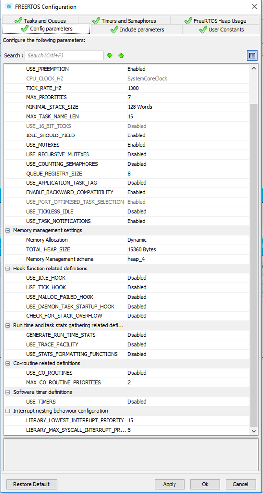

My default FreeRtos settings:

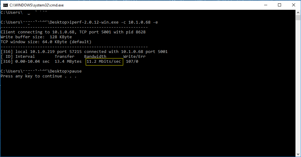

void iperfthread(void *arg) { ethernetif_input(&gnetif); } void iperf_test_start(void) { sys_thread_new(''iperfthread'', iperfthread, NULL, 128, osPriorityRealtime ); } static err_t iperf_recv(void *arg, struct tcp_pcb *pcb, struct pbuf *p, err_t err) { LWIP_UNUSED_ARG(arg); if (err == ERR_OK && p != NULL) { tcp_recved(pcb, p->tot_len); pbuf_free(p); } else if (err != ERR_OK && p != NULL) { pbuf_free(p); } if (err == ERR_OK && p == NULL) { tcp_arg(pcb, NULL); tcp_sent(pcb, NULL); tcp_recv(pcb, NULL); tcp_close(pcb); } return ERR_OK; } static err_t iperf_accept(void *arg, struct tcp_pcb *pcb, err_t err) { LWIP_UNUSED_ARG(arg); LWIP_UNUSED_ARG(err); tcp_arg(pcb, NULL); tcp_sent(pcb, NULL); tcp_recv(pcb, iperf_recv); return ERR_OK; } void iperf_init(void) { struct tcp_pcb *pcb; pcb = tcp_new(); tcp_bind(pcb, IP_ADDR_ANY, 5001); // bind to iperf port pcb = tcp_listen(pcb); tcp_accept(pcb, iperf_accept); } �?�?�?�?�?�?�?�?�?�?�?�?�?�?�?�?�?�?�?�?�?�?�?�?�?�?�?�?�?�?�?�?�?�?�?�?�?�?�?�?�?�?�?�?�?�?�?�?�?�?�?�?�?�?�?�?�?�?�?�?�?�?�?�?�?�?�?�?�?�?�?�?�?�?�?�?�?�?�?�?�?�?�?�?�?�?�?�?�?�?�?�?�?�?�?�?�?�?�?�?�?�?�?�?�?�?�?�?�?�?�?�?�?�?�?�?�?�?�?�?�?�?�?�?�?�?�?�?�?�?�?�?�?�?�?�?�?�?�?�?�?�?�?�?�?�?�?�?�?�?�?�?�?�?�?�?�?�?�?�?�?�?�?�?�?�?�?�?�?�?�?�?�?�?�?�?�?�?�?�?�?�?�?�?�?�?�?�?�?�?�?�?�?�?�?�?�?�?�?�?�?�?�?�?�?�?�?�?�?�?�?�?�?�?�?�?�?�?�?�?�?�?�?�?�?�?�?�?�?�?�?�?�?�?�?�?�?�?�?�?�?�?�?�?�?�?�?�?�?�?�?�?�?�?�?�?�?�?�?�?�?�?�?�?�?�?�?�?�?�?�?�?�?�? im creating simple thread for iperf task. And this is my main
int main(void) { /* Reset of all peripherals, Initializes the Flash interface and the Systick. */ HAL_Init(); /* Configure the system clock */ SystemClock_Config(); /* Initialize all configured peripherals */ MX_GPIO_Init(); MX_RTC_Init(); MX_TIM1_Init(); /* USER CODE BEGIN 2 */ MX_LWIP_Init(); iperf_init(); iperf_test_start(); /* USER CODE END 2 */ /* Start scheduler */ osKernelStart(); /* We should never get here as control is now taken by the scheduler */ /* USER CODE BEGIN WHILE */ while (1) { } }�?�?�?�?�?�?�?�?�?�?�?�?�?�?�?�?�?�?�?�?�?�?�?�?�?�?�?�?�?�?�?�?�?�?�?�?�?�?�?�?�?�?�?�?�?�?�?�?�?�?�?�?�?�?�?�?�?�?�?�?�?�?�?�?�?�?�?�?�?�?�?�?�?�?�?�?�?�?�?�?�?�?�?�?�?�?�?�?�?�?�?�?�?�?�?�?�?�?�?�?�?�?�?�?�?�?�?�?�?�?�?�?�?�?�?�?�?�?�?�?�?�?�?�?�?�?�?�?�?�?�?�?�?�?�?�?�?�?�?�?�?�?�?�?�?�?�?�?�?�?�?�?�?�?�?�?�?�?�?�?�?�?�?�?�?�?�?�?�?�?�?�?�?�?�?�?�?�?�?�?�?�?�?�?�?�?�?�?�?�?�?�?�?�?�?�?�?�?�?�?�?�?�?�?�?�?�?�?�?�?�?�?�?�?�?�?�?�?�?�?�?�?�?�?�?�?�?�?�?�?�?�?�?�?�?�?�?�?�?�?�?�?�?�?�?�?�?�?�?�?�?�?�? Test results are so bad. 11-12Mbits/sec.

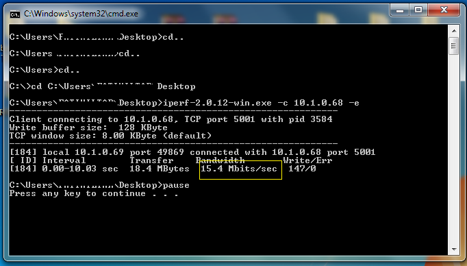

For nucleo board the speed is 15 Mbps
How can i fix and increase it ?

TCP_MSS is set to 536 bytes. I would increase it to 1460 bytes as the TCP header takes 20 bytes + IP header 20 bytes.
This would fit the Ehernet MTU of 1500 bytes.
The goal is to increase the packet size and reduce time spent on processing headers (to lower the number of packets).

CubeMx default settings allows 1426 bytes for TCP_MSS and i used this value. The below captures for 5.23 Mbits/sec iperf result on disco board.
