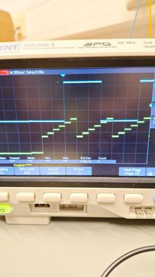

void HAL_DAC_ConvCpltCallbackCh1(DAC_HandleTypeDef *hdac)
 HAL_GPIO_TogglePin(START_OF_FRAME_GPIO_Port , START_OF_FRAME_Pin);
uint32_t val[] = { 500, 600, 700, 800, 900, 1000, 1100, 1200, 1300, 1400};
HAL_DAC_Start_DMA(&hdac1, DAC_CHANNEL_1, val, 10, DAC_ALIGN_12B_R);
HAL_TIM_Base_Start(&htim2);
this is my simple code. why transfer complete interrupt is not on last data?

@Sarra.S thanks for answer. yes it is in circular mode. but starting again take lots of time, i need doing in circular mode and a callback for finishing the buffer.
nimaltd
Senior
Dear @Sarra.S .  This is normal mode. but still has the same problem.
i have attached my project. please have a look. thanks
