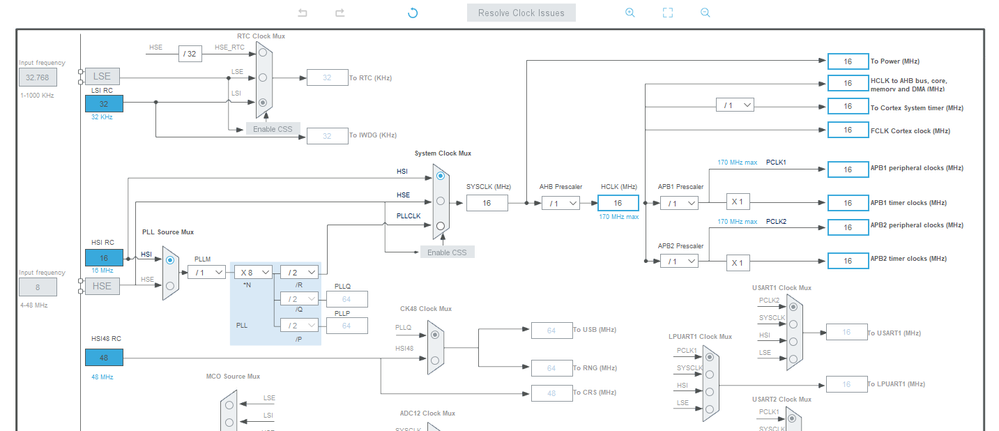

/************************ (C) COPYRIGHT STMicroelectronics *****END OF FILE****/Clock config:
