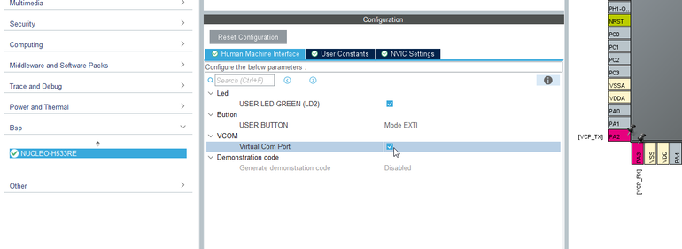

I enabled this option to activate the virtual COM port for debug reasons:
It is a CMake Project to be opened in VS-Code

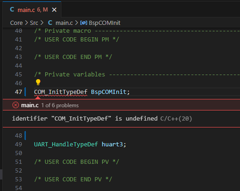

Enabling the Virtual Com Port in CubeMX results in this error in VS Code:

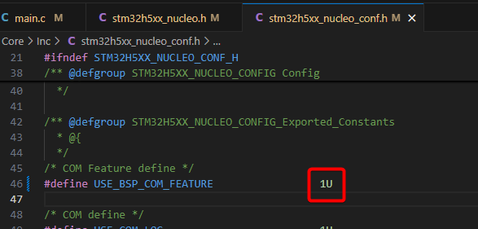

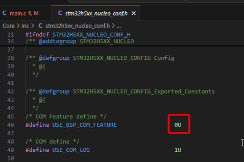

Crawling in the files, I found that the stm32h5xx_nucleo_conf.h the USE_BSP_COM_FEATURE is not enabled.

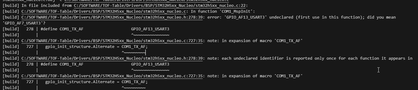

Enabling this manually will result in many more errors:
Generating the code again will reset the USE_BSP_COM_FEATURE to 0.

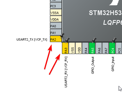

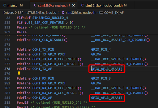

First you need to remove the lock from this pins (right click) ans set manually to USART2 RX/TX as USART3 is not avail on this pins:

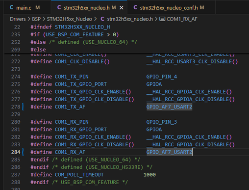

Next you need to set this in the stm32h5xx_nucleo.h
to THIS:
and than set this to 1 in the stm32h5xx_nucleo_conf.h
Now it compiles, but if you re-generate the code with CubeMX your changes will be reverted... nice work STM

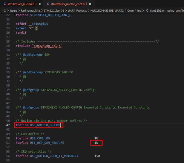

I'm using 6.13.0 and it seems to be setting the #define correctly.

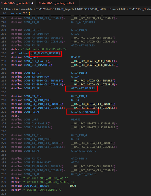

I also don't see line 47 #define USE_NUCLEO_H533RE in you screenshot?
With that define, it would correctly select UART2 for the COM port.

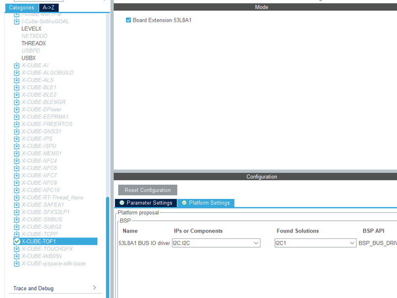

No, this error is not caused by a fresh installation. Although there seems to be an issue here as well. After installing the packages, it is not possible to initialize a project.
The error occurs as soon as the X-CUBE-TOF1 is added. Once this is done, the project is corrupted, and it is no longer possible to compile the project without manual adjustments.
Setup your project like this and you will see, that the project no longer compiles...

When I added the X-CUBE-TOF1 to the project and generated the code...
