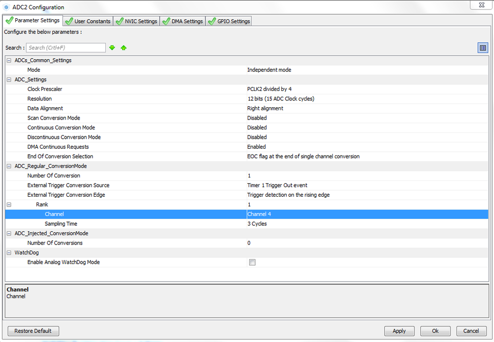

I'm having problems with STM32 CubeMX (v4.19.0) during the setup of the ADC2 peripheral (may be a bug...).
Even if the number of conversion is ONE, I have two different ranks both pointing to the same ADC channel (please refer to the attached screenshot).
I looked into the ioc and some lines don't convince me (I have only channel 4 active):
ADC2.Channel-20\&sharpChannelRegularConversion=ADC_CHANNEL_4
ADC2.Channel-4\&sharpChannelRegularConversion=ADC_CHANNEL_4ADC2.Channel-8\&sharpChannelRegularConversion=ADC_CHANNEL_4...'

2017-03-08 5:51 AM
Could you please precise the device that you are using?
From my side, I have checked for STM32F7xx with the same parameter settings as you and I have one rank :
Maybe, it will be better to share your .ioc file to check this case and identify what is going wrong.
Imen

2017-05-02 3:04 AM
Hi Imen,
unluckily, despite the update to the newest version of the CubeMX plugin,the problem is not solved.
The peripheral works well, but the application still shows 3identical ranks for ADC2.
Any suggestion?
Thanks
Flavio
